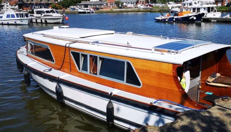

Welcome and good luck with your restoration project 👍 I owned Dakota for a while a few years back, her restoration had been done before I bought her so unfortunately can't really help with technical knowledge but attach some photos for reference. She is still owned and run on the Broads by the way.
* She was previously named Sir Losis of the River
  • Like 7

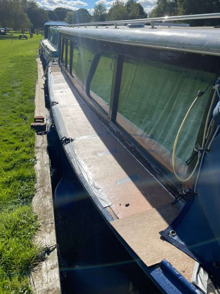

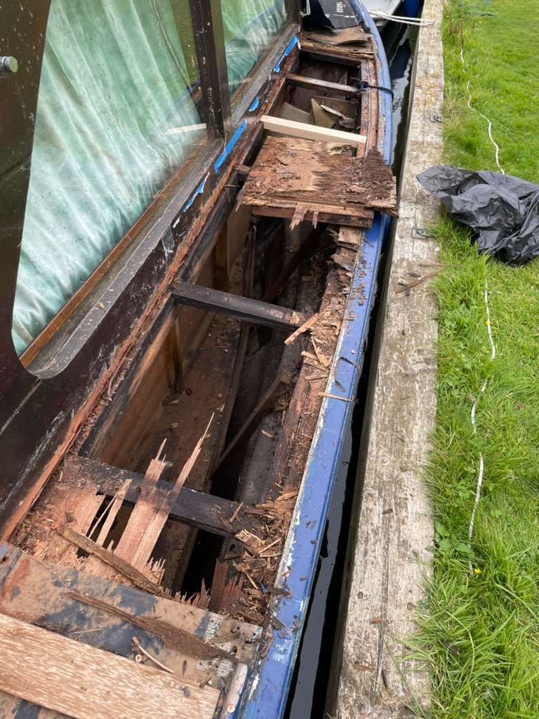

Posted
Having a look through the side decking. Plenty of ex-ply now the consistency of paper maché. New 18mm ply seems to slot in its place pretty well. Ideally this would all be on a hard somewhere or under cover, but needs must and all that. I'll have to replace the rubbing strakes another year, so maybe some penetrating epoxy or wood hardener may have to do for now.
Has anyone any experience using either on what I think if oak?

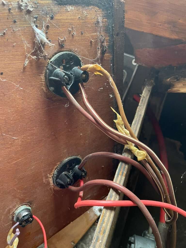

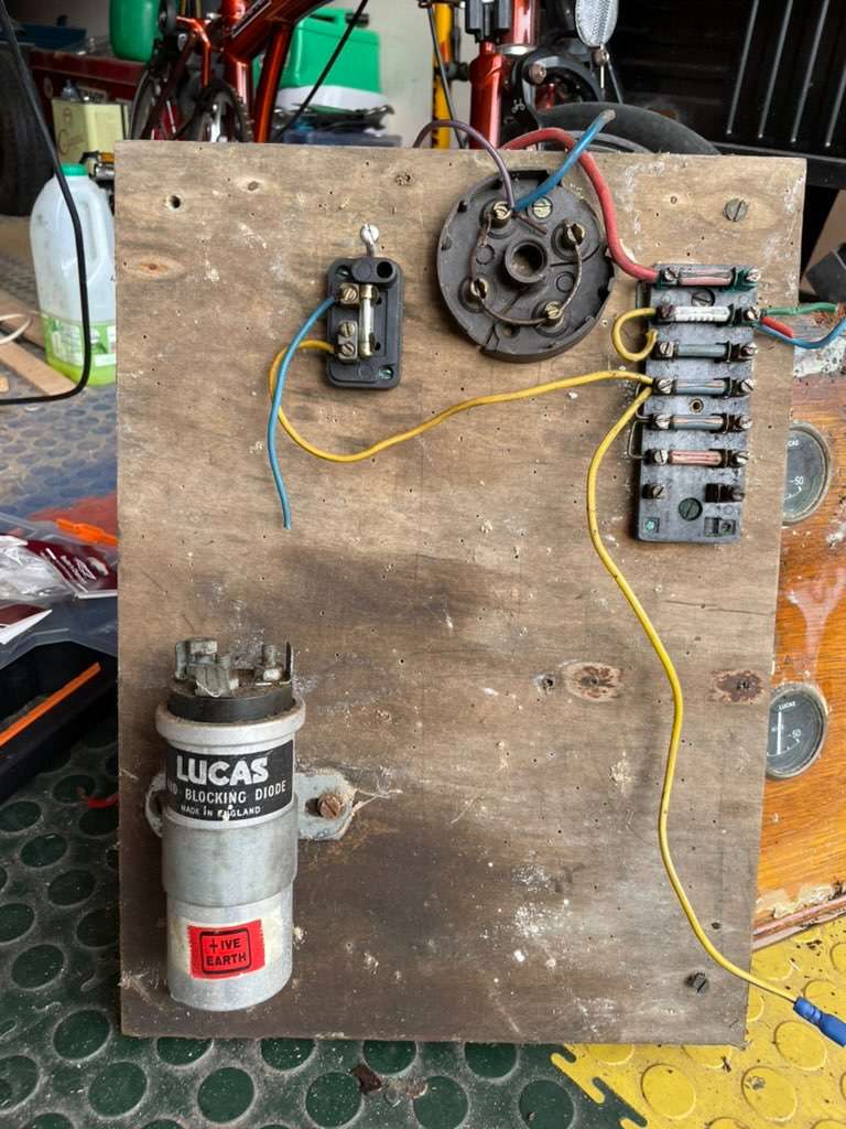

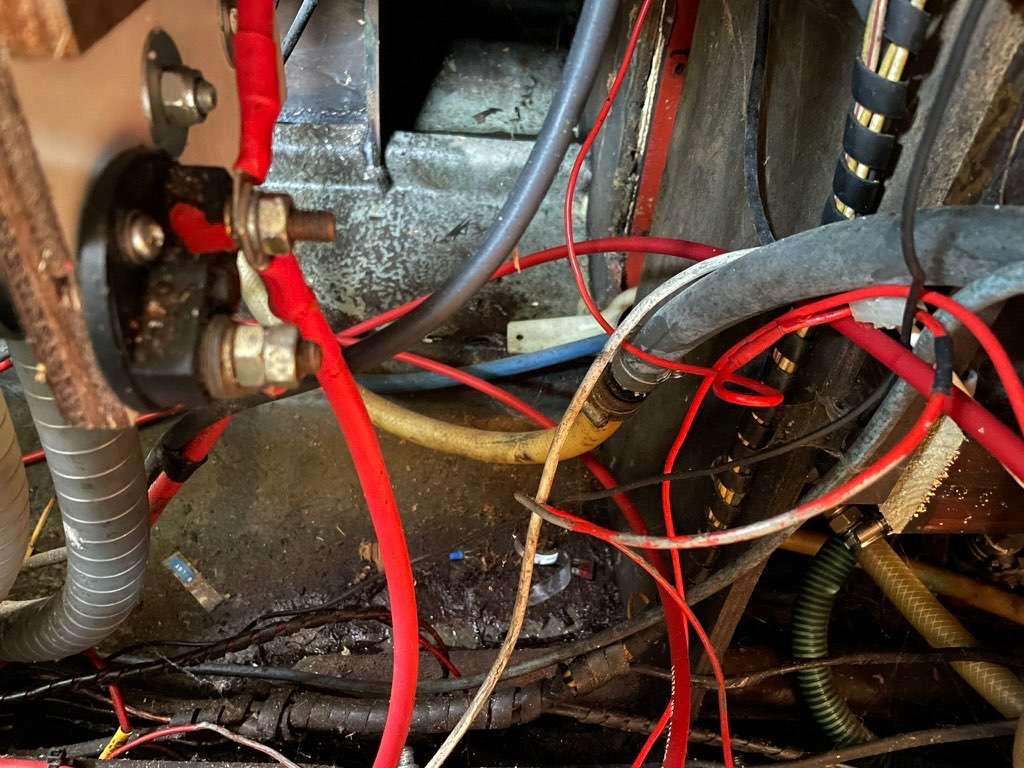

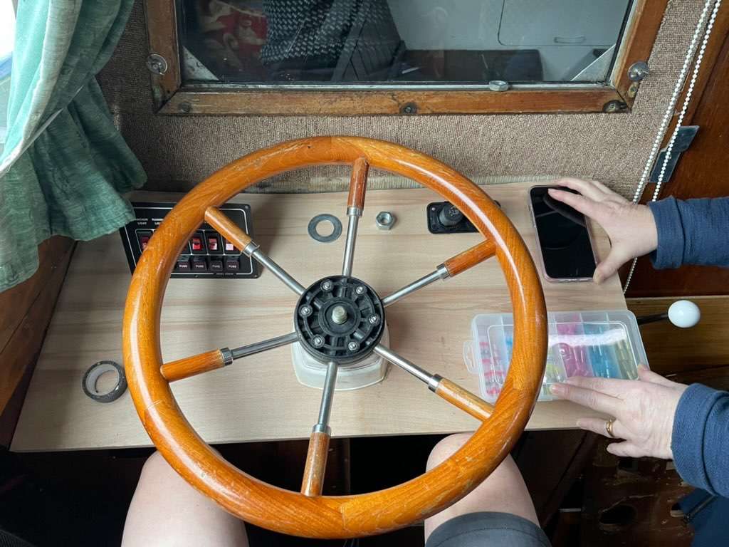

So winter's closing in and now having to work inside. I got perhaps 3/4 of the starboard deck replaced and learnt a great deal. So will be able to progress faster in the spring. So moving on towards the electrics. Just as awful as the timber, so pretty much starting from scratch. Which is fine and I'm learning new skills every time I touch the boat.
A near miss with the bilge pump as knocked the live wire of the switch. So bilge wasn't running for a few weeks. There was a lot (i.e. so very much) of water to pump out by the time I noticed. Well at least it gave the batteries a good rinse! Excuse the drama, luckily wasn't quite high enough to touch the terminals. Anyways, all sorted now.

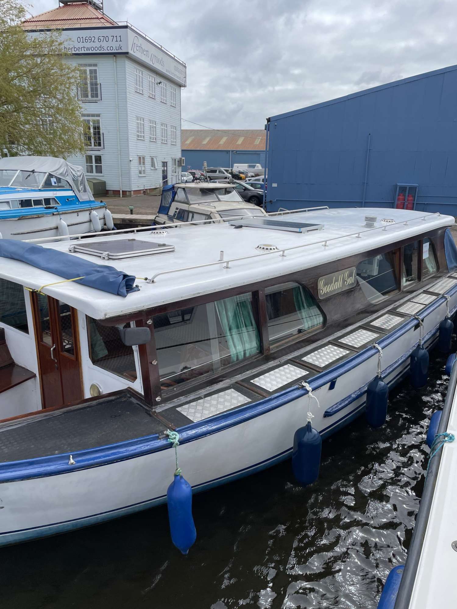

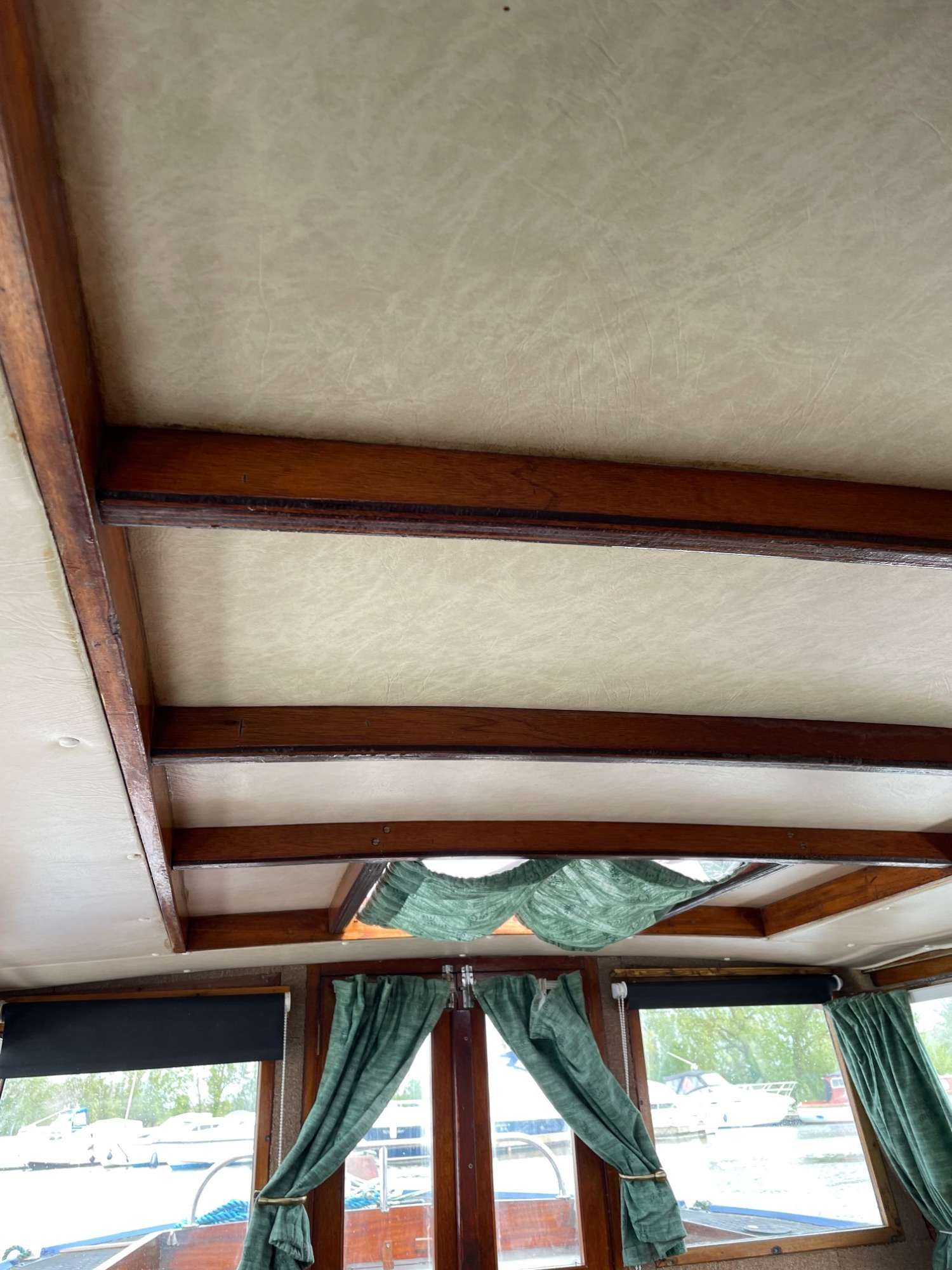

Looking forward into the glorious future, i'd like to put in a sliding roof. It looks like her sisters had such, but Dren doesn't. There does seem to be a frame on the inside of the boat and I wonder if maybe a sliding roof used to be there but was removed. Has anyone got any ideas on if I can get new sliders or mechanisms, or even a second hand roof and accessories anywhere. I'm quite happy to do the woodwork, but would need sliding mech.
Covert the above to something similar to the picture below?
Posted
Fibreglass topped boats tend to have channels for sliding hatches moulded into their superstructure whereas wooden topped boats have rails above the roof for the hatch to sit and slide on. I suspect it's this sort of design you'll be following so, if it was me, I'd be looking to visit Martham Boats and copying their system from a Judith or similar.
Having said that, if David from Judith M is reading this and has a piccy, his hatch design and rail is exactly what you need to be aiming for.
