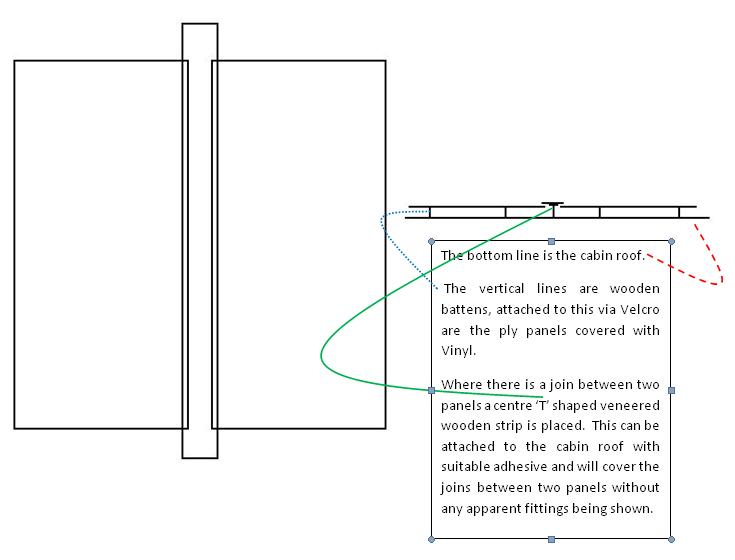

II apologise for my drawing skills here using 'Paint' but...This is how I have seen some boats finished as to headlining.
Personally I like the idea of the insert strips to stand away from the surrounding vinyl covered ply panel by a few millimetres which would then allow L.E.D light strips in the small gap between panel and cabin roof to ‘glow through’ in the evening..

I see what you mean Robin, a little like a threshold joining two floor coverings in a doorway. Definately something to consider.

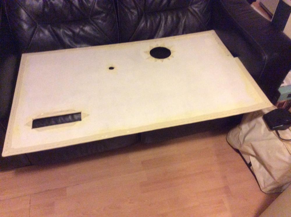

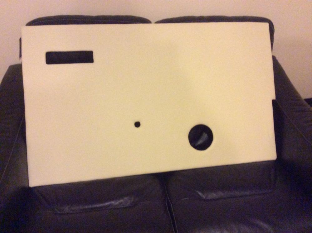

At the moment our living room resembles a workshop as I've started to cover the panels. A pic of my very first attempt is attached both front and back. We went for foam backed lining and my fingertips are suffering from peeling off the foam around the edges :smile:
